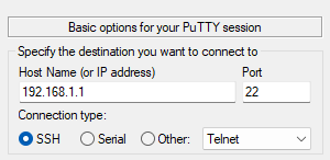

Wydaje mi się, że ciężko będzie w LuCi to zrobić.  Pobierz Putty.  Ustaw IP  routera.
Kliknij OPEN
Zaloguj się do routera. ( SSH nie działa, jeżeli nie zmieniłeś hasła.)

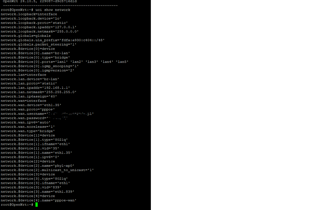

Pokaż co tam masz
uci show network

Nie wklejaj mi screenów tylko tekst :D. Zaznaczasz tekst, klikasz "Enter". To wrzuci zaznaczony tekst do schowka.

root@OpenWrt:~# uci show network
network.loopback=interface
network.loopback.device='lo'
network.loopback.proto='static'
network.loopback.ipaddr='127.0.0.1'
network.loopback.netmask='255.0.0.0'
network.globals=globals
network.globals.ula_prefix='fdfa:a930:c404::/48'
network.globals.packet_steering='1'
network.@device[0]=device
network.@device[0].name='br-lan'
network.@device[0].type='bridge'
network.@device[0].ports='lan1' 'lan2' 'lan3' 'lan4' 'lan5'
network.@device[0].igmp_snooping='1'
network.@device[0].igmpversion='2'
network.lan=interface
network.lan.device='br-lan'
network.lan.proto='static'
network.lan.ipaddr='192.168.1.1'
network.lan.netmask='255.255.255.0'
network.lan.ip6assign='60'
network.wan=interface
network.wan.device='eth1.35'
network.wan.proto='pppoe'
network.wan.username=''
network.wan.password=''
network.wan.ipv6='auto'
network.wan.norelease='1'
network.wan.type='bridge'
network.@device[1]=device
network.@device[1].type='8021q'
network.@device[1].ifname='eth1'
network.@device[1].vid='35'
network.@device[1].name='eth1.35'
network.@device[1].ipv6='0'
network.@device[2]=device
network.@device[2].name='phy1-ap0'
network.@device[2].multicast_to_unicast='1'
network.@device[3]=device
network.@device[3].type='8021q'
network.@device[3].ifname='eth1'
network.@device[3].vid='839'
network.@device[3].name='eth1.839'
network.@device[4]=device
network.@device[4].name='pppoe-wan'
root@OpenWrt:~#
Proszę, usunąłem tylko dane logowania do usługi.
