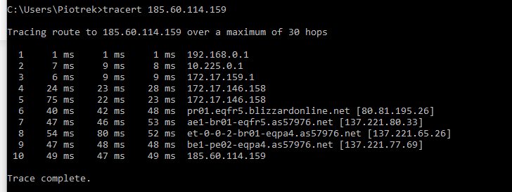

Tracing route to 185.60.114.159 over a maximum of 30 hops
  1     1 ms     1 ms     1 ms  FUNBOX [192.168.1.1]
  2    38 ms    38 ms    45 ms  kiel-bng1.tpnet.pl [80.50.18.42]
  3    48 ms    38 ms    40 ms  kiel-r1.tpnet.pl [80.50.18.41]
  4    42 ms    41 ms    40 ms  war-r1.tpnet.pl [194.204.175.61]
  5    57 ms    58 ms    58 ms  war-b2-link.telia.net [213.248.89.85]
  6    63 ms    64 ms    64 ms  ffm-bb4-link.telia.net [213.155.134.212]
  7    65 ms    67 ms    72 ms  ffm-b1-link.telia.net [62.115.137.167]
  8    60 ms    61 ms    83 ms  blizzard-ic-316506-ffm-b1.c.telia.net [213.248.76.103]
  9    69 ms    69 ms    69 ms  ae1-br01-eqfr5.as57976.net [137.221.80.33]
 10    69 ms    70 ms    69 ms  et-0-0-2-br01-eqpa4.as57976.net [137.221.65.26]
 11    70 ms    69 ms    68 ms  be1-pe02-eqpa4.as57976.net [137.221.77.69]
 12     *        *        *     Request timed out.
 13     *        *        *     Request timed out.
 14     *        *        *     Request timed out.
 15     *        *        *     Request timed out.
 16     *        *        *     Request timed out.
 17     *        *        *     Request timed out.
 18     *        *        *     Request timed out.
 19     *        *        *     Request timed out.
 20     *        *        *     Request timed out.
 21     *        *        *     Request timed out.
 22     *        *        *     Request timed out.
 23     *        *        *     Request timed out.
 24     *        *        *     Request timed out.
 25     *        *        *     Request timed out.
 26     *        *        *     Request timed out.
 27     *        *        *     Request timed out.
 28     *        *        *     Request timed out.
 29     *        *        *     Request timed out.
 30     *        *        *     Request timed out.
Trace complete.
  0  DESKTOP-E2IVRRO.home [192.168.1.10]
  1  FUNBOX [192.168.1.1]
  2  kiel-bng1.tpnet.pl [80.50.18.42]
  3  kiel-r1.tpnet.pl [80.50.18.41]
  4  war-r1.tpnet.pl [194.204.175.61]
  5  war-b2-link.telia.net [213.248.89.85]
  6  ffm-bb4-link.telia.net [213.155.134.212]
  7  ffm-b1-link.telia.net [62.115.137.167]
  8  blizzard-ic-316506-ffm-b1.c.telia.net [213.248.76.103]
  9  ae1-br01-eqfr5.as57976.net [137.221.80.33]
 10  et-0-0-2-br01-eqpa4.as57976.net [137.221.65.26]
 11     *     be1-pe02-eqpa4.as57976.net [137.221.77.69]
 12     *        *        *
Computing statistics for 275 seconds...
            Source to Here   This Node/Link
Hop  RTT    Lost/Sent = Pct  Lost/Sent = Pct  Address
                                3/ 100 =  3%   |
  1    5ms     8/ 100 =  8%     5/ 100 =  5%  FUNBOX [192.168.1.1]
                                0/ 100 =  0%   |
  2   42ms     8/ 100 =  8%     5/ 100 =  5%  kiel-bng1.tpnet.pl [80.50.18.42]
                                0/ 100 =  0%   |
  3   40ms     5/ 100 =  5%     2/ 100 =  2%  kiel-r1.tpnet.pl [80.50.18.41]
                                0/ 100 =  0%   |
  4   47ms     6/ 100 =  6%     3/ 100 =  3%  war-r1.tpnet.pl [194.204.175.61]
                                0/ 100 =  0%   |
  5   63ms     5/ 100 =  5%     2/ 100 =  2%  war-b2-link.telia.net [213.248.89.85]
                                0/ 100 =  0%   |
  6   65ms     5/ 100 =  5%     2/ 100 =  2%  ffm-bb4-link.telia.net [213.155.134.212]
                                0/ 100 =  0%   |
  7   67ms     3/ 100 =  3%     0/ 100 =  0%  ffm-b1-link.telia.net [62.115.137.167]
                                3/ 100 =  3%   |
  8   65ms     6/ 100 =  6%     0/ 100 =  0%  blizzard-ic-316506-ffm-b1.c.telia.net [213.248.76.103]
                                2/ 100 =  2%   |
  9   64ms     8/ 100 =  8%     0/ 100 =  0%  ae1-br01-eqfr5.as57976.net [137.221.80.33]
                                2/ 100 =  2%   |
 10   72ms    11/ 100 = 11%     1/ 100 =  1%  et-0-0-2-br01-eqpa4.as57976.net [137.221.65.26]
                                0/ 100 =  0%   |
 11   72ms    10/ 100 = 10%     0/ 100 =  0%  be1-pe02-eqpa4.as57976.net [137.221.77.69]
Trace complete.

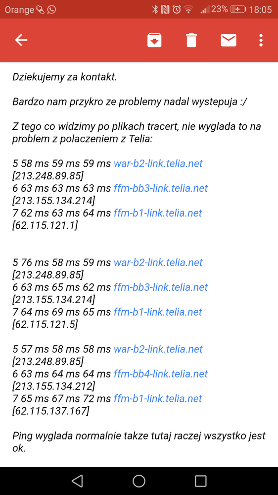

Aha...czyli reasumując problem ten orange ma głęboko w poważaniu i ani ja, ani orange nie jest w stanie nic z tym zrobić? Ot, jak mam pecha to trace pakiety?

Problem z internetem, tracerout
Tak, wiedz od kilku lat i nic z tym nie robią.
  • 33157
  • 41170
Pakiety i ping nie są gwarantowane przy Neostradzie.
  • 2431
  • 4151
U innych operatorów też nie są gwarantowane a działa ok. Apelował bym abyś zakończył dawać tak głupie odpowiedzi, bo z 14k postów 1/4 jest takich.

W tym wypadku nie działa też u innych. Sprawdziłem w u siebie w Vectrze i na mobilnym plusie. Wszystko powyżej sekundy. Widać, że coś blizzard nie wyrabia.

Gdyby się nie ogłaszali że są dobrym internetem dla graczy to by nie było tego lamentu. Ostatnio zapłacili graczom virtus.pro by powiedzieli jaki ten internet jest wspaniały.
Nie możesz też zaprzeczyć że problemów nie ma, bo są, co było udowadniane na tym forum setki razy
Konkurencja nic nie gwarantuje a problemy są sporadyczne nie z ich winy. A te problemy z routingiem są ewidentnie ich wina, bo jakby chcieli to by już to dawno zrobili, a nie zrobili, bo jak nie wiadomo o co chodzi to chodzi o pieniądze.
@up. W Vectrze masz ok, plus jako mobilniak nie do testów.. 😉

Rozumiem, jezeli orange nie ma wpływu na te utraty pakietów, jednak nie pisze tutaj pierwszy raz, na moją opinię składa się wiele sytuacji.
Pamietam, że chyba podobne problemy były w lolu - orange na początku informowalo, ze wina lezy po stronie riot games, co było nieprawdą. Problem byl na większą skale i po czasie okazało się, że jednak problem byl po stronie orange i nawet udało sie go zlikwidować. Chyba, bo może było na odwrót, ale wydaje mi się ze tak to wyglądało, zresztą to bez większego znaczenia.
Otrzymałem odpowiedź od supportu, jest w załączniku n Screenshot_20180826-180514.png

Problemy są takie same w każdej sieci. Teraz przez najbliższy tydzień będą same takie problemy. Czemu? Nie łatwo spojrzeć w kalendarz i stwierdzić, że kończą się wakacje. Dopiero koło 5.09 będzie lepiej i to nie wynik działania żadnego operatora.
Poza tym e-sportowcy reklamują światłowód, a podejrzewam, że @Atraud ma usługi na miedzi (duże opóźnienie do kieleckiego routera).
