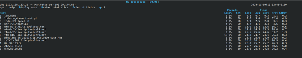

Pokaż traceroute z obu tych sieci do tego jednego serwera
  • 16
Światłowód Pro 2.0 timeouty od kilku dni
Orange:
bbfw (192.168.133.57) -> www.heise.de (193.99.144.85)                 2024-11-06T13:06:21+0100
Keys:  Help   Display mode   Restart statistics   Order of fields   quit
                                                      Packets               Pings
 Host                                               Loss%   Snt   Last   Avg  Best  Wrst StDev
 1. _gateway                                         0.0%    50    0.9   0.8   0.3   1.9   0.3
 2. lodz-bng4.neo.tpnet.pl                           0.0%    50    5.3   5.1   1.9  23.3   4.5
 3. lodz-r22.tpnet.pl                                0.0%    50    2.6   2.5   1.8   3.5   0.4
 4. war-r21.tpnet.pl                                34.0%    50    5.3   4.1   3.4   5.4   0.5
 5. win-b2-link.ip.twelve99.net                      0.0%    50   14.5  14.2  13.4  15.5   0.4
 6. win-bb2-link.ip.twelve99.net                     0.0%    50   14.2  14.6  13.8  21.8   1.2
 7. ffm-bb2-link.ip.twelve99.net                    22.0%    50   24.9  25.5  24.9  26.7   0.5
 8. ffm-b16-link.ip.twelve99.net                    18.4%    50   25.0  24.9  24.0  25.9   0.4
 9. plusline-ic-323934.ip.twelve99-cust.net          0.0%    50   25.6  25.8  24.6  30.5   1.0
10. te2-2.c301.f.de.plusline.net                     0.0%    50   26.0  26.0  25.5  26.8   0.3
11. 82.98.103.3                                      0.0%    50   25.7  25.7  25.0  27.3   0.4
12. 212.19.61.13                                     0.0%    50   25.4  25.4  24.6  26.2   0.4
13. www.heise.de                                     0.0%    50   25.9  25.5  24.5  29.8   0.7
Play LTE:
bbfw (172.20.10.5) -> www.heise.de (193.99.144.85)                    2024-11-06T13:14:33+0100
                                                      Packets               Pings
 1. _gateway                                         0.0%    50    6.3  27.5   3.1 180.0  42.6
 2. (waiting for reply)
 3. (waiting for reply)
 4. (waiting for reply)
 5. (waiting for reply)
 6. (waiting for reply)
 7. (waiting for reply)
 8. war-b4-link.ip.twelve99.net                     81.6%    50   29.3  48.0  25.4 142.6  36.4
 9. (waiting for reply)
10. ffm-b16-link.ip.twelve99.net                    36.7%    50   56.4  71.5  40.4 185.1  39.0
11. (waiting for reply)
12. (waiting for reply)
13. (waiting for reply)
14. 212.19.61.13                                     0.0%    50   47.0  67.4  40.7 167.4  29.4
15. www.heise.de                                     0.0%    50   49.5  76.4  44.7 189.3  45.8
Zrzut ekranu dla łatwiejszego czytania

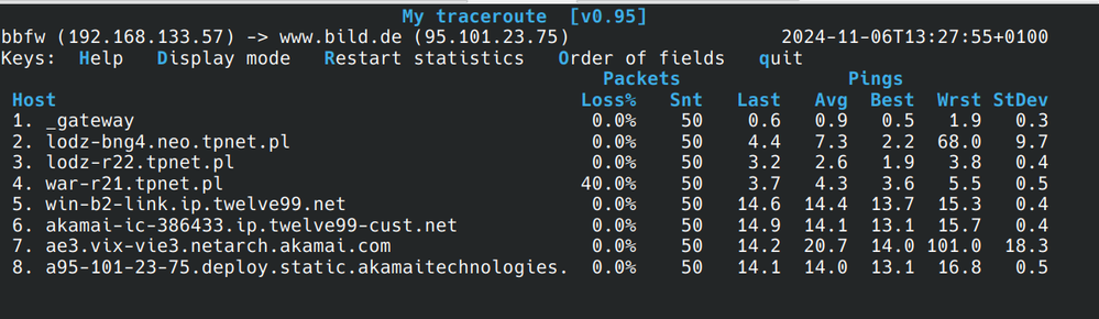

Poprawka: www.bild.de wydaje się teraz działać.
Kolejny test z błędami www.bild.de (duża gazeta informacyjna):
bbfw (192.168.133.57) -> www.bild.de (95.101.23.75)                   2024-11-06T13:27:55+0100
                                                      Packets               Pings
 1. _gateway                                         0.0%    50    0.6   0.9   0.5   1.9   0.3
 2. lodz-bng4.neo.tpnet.pl                           0.0%    50    4.4   7.3   2.2  68.0   9.7
 3. lodz-r22.tpnet.pl                                0.0%    50    3.2   2.6   1.9   3.8   0.4
 4. war-r21.tpnet.pl                                40.0%    50    3.7   4.3   3.6   5.5   0.5
 5. win-b2-link.ip.twelve99.net                      0.0%    50   14.6  14.4  13.7  15.3   0.4
 6. akamai-ic-386433.ip.twelve99-cust.net            0.0%    50   14.9  14.1  13.1  15.7   0.4
 7. ae3.vix-vie3.netarch.akamai.com                  0.0%    50   14.2  20.7  14.0 101.0  18.3
 8. a95-101-23-75.deploy.static.akamaitechnologies.  0.0%    50   14.1  14.0  13.1  16.8   0.5
Jak dotąd wydaje się, że zawsze otrzymuję błędy, gdy przechodzi przez: war-r21.tpnet.pl
  • 16
Aktualizacja: nadal wygląda na to, że war-r21.tpnet.pl i być może war-r22.tpnet.pl (wygląda na to, że losowo wybrana trasa jest używana) powodują problem.
Na przykład www.amzon.de działa dobrze, o ile używa następującej trasy:
$ traceroute -f 2  -q 1 www.amazon.de
traceroute to www.amazon.de (13.227.155.38), 30 hops max, 60 byte packets
 2  lodz-bng4.neo.tpnet.pl (83.1.5.146)  3.059 ms
 3  lodz-r11.tpnet.pl (80.50.151.121)  2.973 ms
 4  gda-r12.tpnet.pl (195.116.35.114)  18.102 ms
 5  99.83.95.156 (99.83.95.156)  18.075 ms
W przypadku użycia `war-r21.tpnet.pl (195.116.35.157) 4.878 ms` również widzę problemy z tym hostem.
